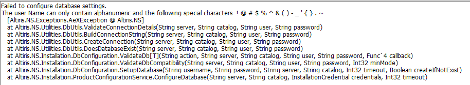

The user Name can only contain alphanumeric and the following special characters.

The Application Identify (aka AppID) account was changed from [SMPDom\altirissv01] to [SMPDom\altirissv02] using the steps from INFO4004
Then, an upgrade was performed via Symantec Installation Manager (aka SIM); However, during the configuration process the following error occurred:
The username or password doesn't contain any other different special character from the valid list mentioned above in the error message.
Related NS logs entries:
Entry 1:
Failed to validate database access credentials
Entry 2:
Failed to configure database settings.
Entry 3:
