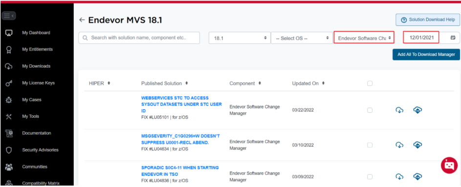

Now click (expand) on Endevor MVS and select the release of Endevor for which solutions are needed
The next screen will be presented.

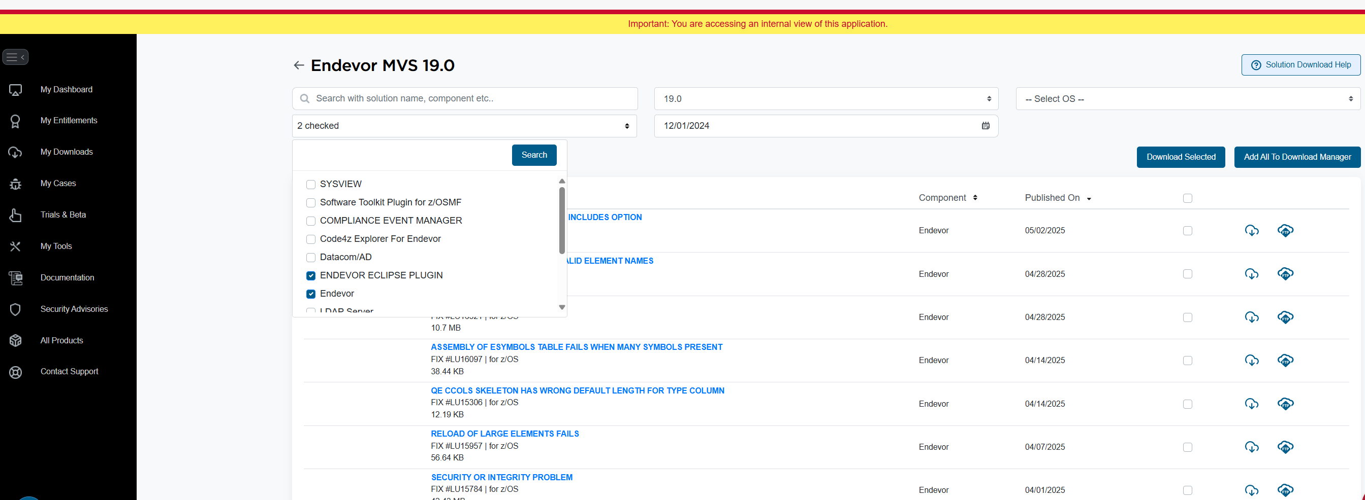

Click on "Select Component" - then select "Endevor & Endevor Eclipse Plugin" and the date for example 12/01/2024 - will list all the PTFS published since 12/1/2024.
Click on "Add All To Download Manager" (this will add all PTFs):

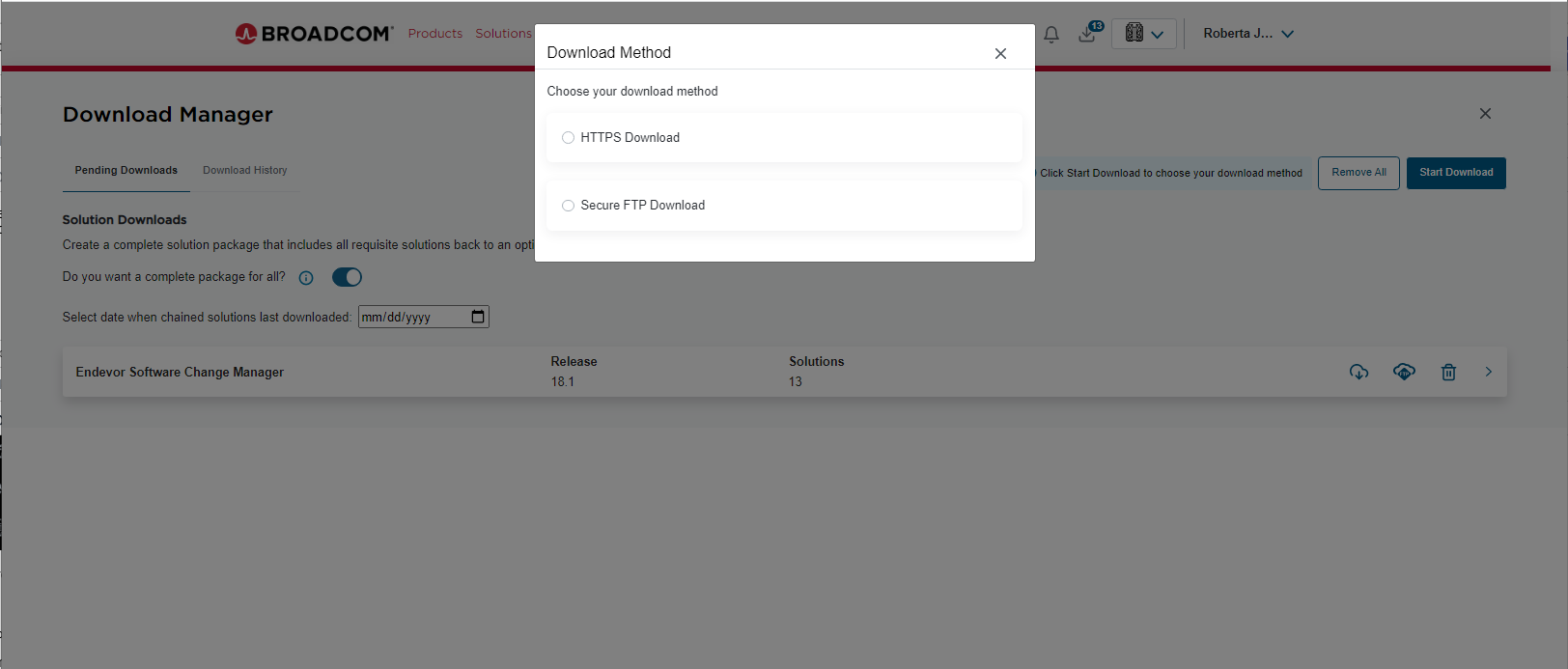

From the Download Manager screen click on the option to download -  then select the download method of your choice:
- HTTPS will download to your desktop
- FTP will create an FTP Directory from which to download the zip file.
