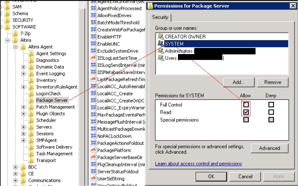

The package server agent (PSA) needs to establish entries within “HKLM\Software\Altiris\Altiris Agent\Package Server” and was prevented from doing so because the SYSTEM account did not inherit ‘Full Control’ permissions from the folder/keys above it.
 The reason this occurred could have been user interference, a GPO, or another security program.
While logged into the Package Server machine as an administrative account, run REGEDIT and browse to “HKLM\Software\Altiris\Altiris Agent\Package Server
Right-click on the "Package Server" key and select "Permissions", then, manually grant the SYSTEM account full control permissions to the folder.
