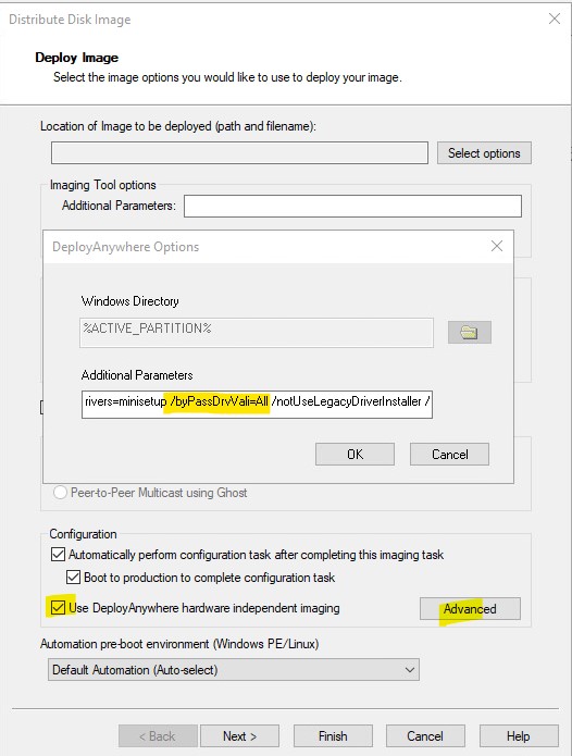

DPinst.exe is not configured to 'Bypass Driver Validation'
In DS 8.x, DPinst.exe runs during mini-setup to allow unsigned drivers to be installed. To use unsigned drivers set: 'Bypass Driver Validation: All'
DS Imaging task:
For Scripted OS Install:
In Ghost Solution Suite 3.3.x Deploy Image task:
Select Use DeployAnywhere hardware independent Image > 'Advanced' Button
add /byPassDrvVali=All to the to Parameters section
