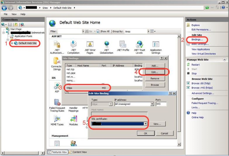

In this case, it was found that an SSL certificate was not bound to port 443 in the IIS settings.
Bind a certificate to port 443 in the IIS settings. This is required even if the Notification Server is not configured to use SSL/HTTPS. It is acceptable to use the default server certificate, if needed.
The following is a screenshot showing the steps to bind a certficate to port 443 in IIS. If needed, 'Add' the entry for HTTPS Port 443 bindings, then apply a certificate to entry for port 443:
