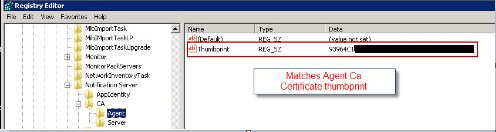

The agent CA is missing from the trusted root certificate store.  See the following screenshots
When the server is installed and configured an agent CA certificate is created.  If you have a backup copy of this certificate you can restore it and make sure that the thumbprint in the certificate matches the thumbprint stored in the registry.  You can view the thumbprint in the certificate using the Microsoft Management Console and loading the certificate snap-in.  Open the certificate and look at the details tab and validate the thumbprint matches the one in the registry location below.
HKEY_LOCAL_MACHINE_SOFTWARE\Altiris\eXpress\Notification Server\CA\Agent\Thumbprint
The thumbprint in the registry should match the thumbprint of the Agent CA certificate located in the trusted root certificate store.  If the certificate is missing from the store you will see the error.  If you have a backup of the certificate you can restore it and it should work.   If you dont, you will have to run aexconfig and reconfigure the server to generate a new one.   This will create a new certificate.  However,  If this is an existing environment you will have to put this new certificate on any existing machines.  Any existing CEM machines would have the old certificate and will to have this updated certificate.
The certificate you restore should match the one in the registry.
