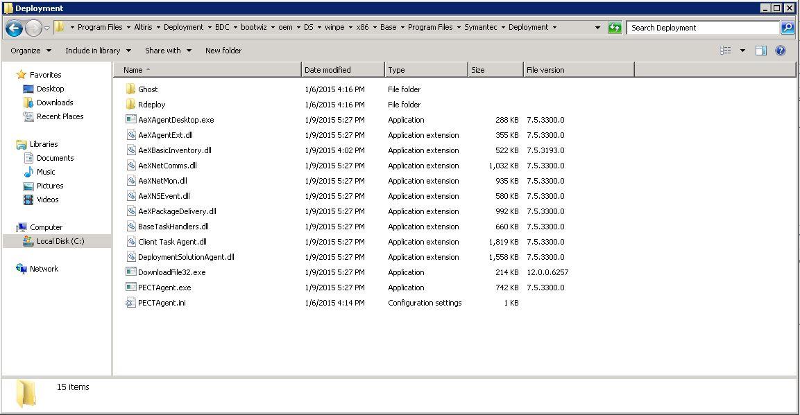

The following steps are to show you how to properly replace the files.  These two screenshots show you which files should be in the x86 and x64 locations:
X64:
x86:
