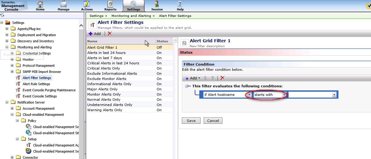

Under Settings > Monitoring and Alerting > Alert Filter Settings it is possible to create custom alert filters and configure specific conditions for them. It is identified that for "Alert hostname" filter condition some of evaluation conditions will cause empty Filters list under Manage > Events and Alerts. Following are the conditions which actually affected:
  1. Starts With,
  2. Does not Start With,
  3. Ends With,
  4. Does not End With.
Other conditions used during creation works fine.
Following warning appearing in SMP logs: EventConsole:Service::GetDataSourceData() exception Exception: Source='Altiris.EventConsole.BusinessLogic', Message='The comparison type is not valid for the condition type.'
