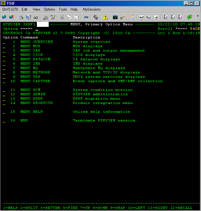

SYSVIEW:
<Please see attached file for image>
Figure 1
From the main SYSVIEW menu, select "2 Menu MVS":
Figure 2

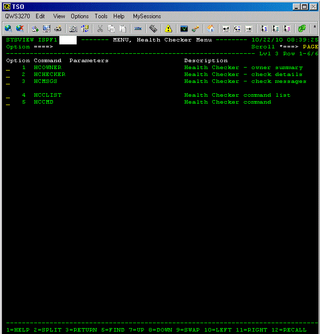

From the MVS menu select "12 MENU HCHECKER"
Figure 3

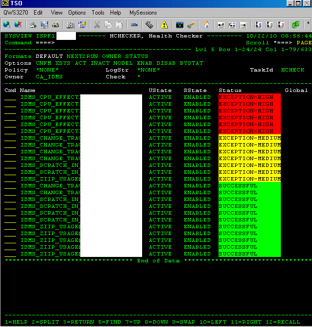

From the HCOWNER screen, select CA_IDMS
Figure 5
Select any of the individual checks to see results.
Figure 6
