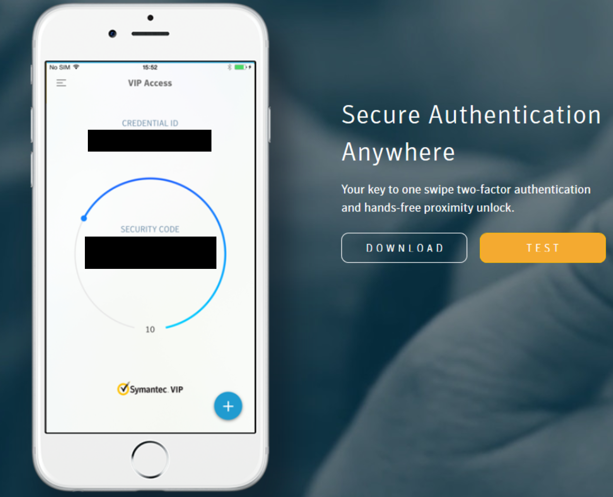

For VIP Access for Mobile and VIP hard tokens, follow these steps:
  1. Verify the time zone and system time on the device are correct.
  2. Go to https://vip.symantec.com/.
  3. Click on Test to the right of the phone image.
  4. Enter the Credential ID in the provided field.
  5. Click Continue.
  6. Enter the security code from your device. If the credential is working properly a success message will appear.
  7. If it fails, wait for a new security code to generate and try again. You may need to repeat this step 2-3 times.
  8. Click Done.
