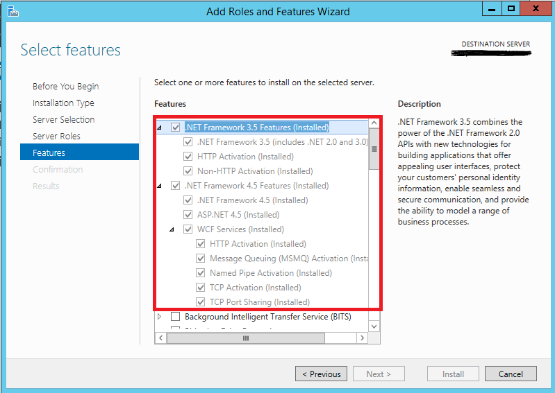

 Windows server 2012 R2 requires additional feature.
Symantec Installation Manager can be installed on Windows 2012 R2 however it requires the below additional feature.
These features can be added from Server Roles.
  1. .Net FrameWork 3.5 Features
    • .NET Framework 3.5 ( includes .NET 2.0 and 3.0)
  2. .NET Framework 4.5 Features
    • .NET Framework 4.5
Note:
.NET Framework 3.5 SP1 is a prerequisite for the installation of Symantec Installation Manager, if for some reason .NET Framework 3.5 SP1 can't be installed, you may want to take a look at the following Microsoft article for a fix on failures on installing .NET 3.5:
Go to URL: https://support.microsoft.com/en-us/kb/3005628
and try the following from the mentioned article above:
Execute:
Customers who receive and install update 3005628 from Microsoft Update channels do not have to take any additional action. Individual customers or IT professionals who decide to run update 3005628 manually or within their managed environments should refer to the "Download information" and "Command-line switches for this update" sections for more information.
Then install .NET 3.5 from Add roles and features.
