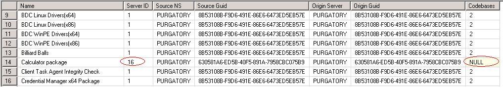

3. The previous query will return detailed information about the known packages. The last column in the query, “Codebases”, will show either a numeric value or NULL.
As per the following graphic you may notice packages where the server is the same as all of the others (or another server’s name is displayed). Usually, if the “Codebases” column is NULL then the [Server ID] value will be different than those where the “Codebases” column has a numeric value.
You will also usually notice that the GUID in the “Source Guid” column, where the “Codebases” column has a numeric value, is the same as the OwnerNSGuid in CoreSettings.config.
  • If there is a difference in the values of the “Server ID” between packages where Codebases are NULL and those that have a numeric value, then this means that the packages with NULL codebases need to be assigned to the server ID that is aligned with the GUID in CoreSettings.config
