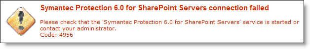

When connecting to Symantec Protection for SharePoint Servers 5.1.x  or 6.x (SPSS) Console, an error is displayed and the Graphical Interface does not show up.
The following error may be displayed when attempting to connect to the Symantec Protection for SharePoint Servers (SPSS) Console:

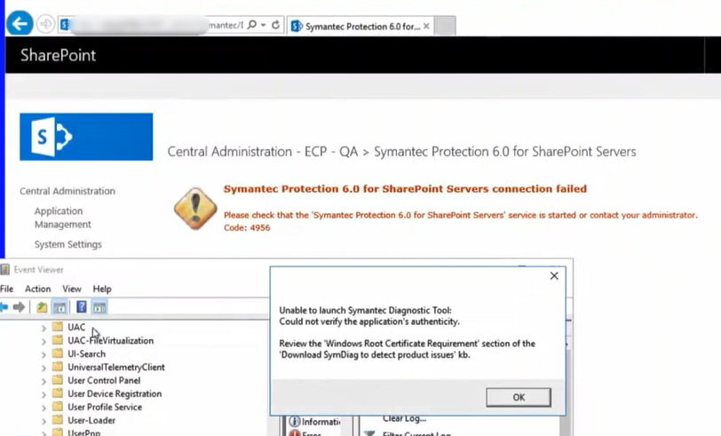

     2.  Download a copy of the SymDiag tool and see if it runs.   Download SymDiag to detect product issues
     3.  If the following error message displays when executing SymDiag, refer to the following SymDiag article to update the certificate.
           Failed to launch Symantec Diagnostic Tool
