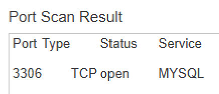

Note: Ensure port 3306 is open between PAM and the MySQL Server.

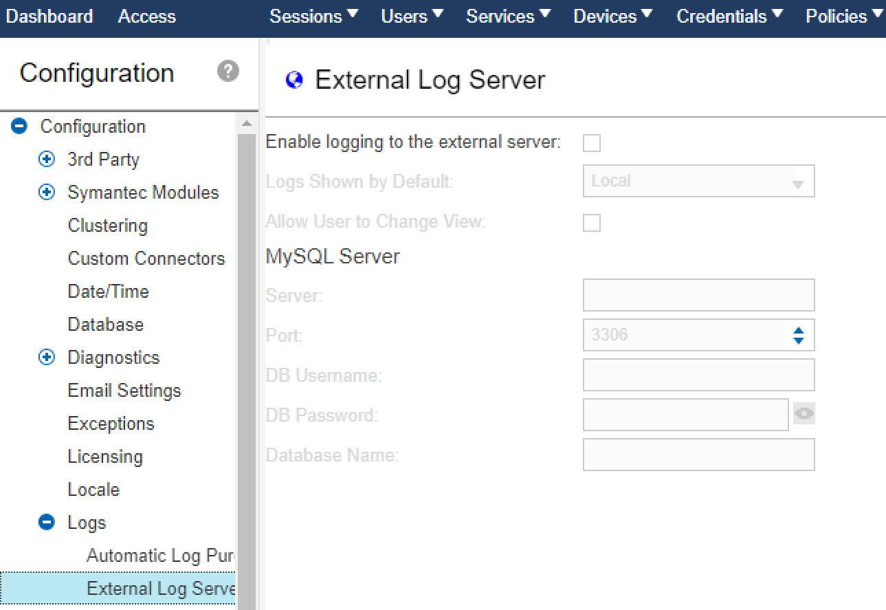

    5) Login to PAM and go to:
    • Configure the External Log Server by checking the "Enable logging to the external server" checkbox.
    • Enter the server IP where the DB is connected, port and credentials.
    • 3.x and 4.x.x: Configuration>>Logs>>External Log Server
    5) Click on Update. You should get the following message:
