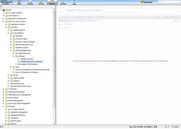

When running the "Installed Software by Computer" report for all of the computers in your environment, the report timesout and displays an error message:
The report execution time exceeded server timeout. Please refresh this page to retry. If the problem continues please contact your administrator
ITMS 8.x
The main cause of the issue is the large amount of data that the report is attempting to retrieve. With all fields set to Wildcards, the amount of data to sift through can cause the timeout limit to be reached.
This report was updated in ITMS 7.1 SP2, and we've had reports of greater success. If you are using an earlier version, or are still experiencing issues, you can use the below report:
Please create a Custom SQL Report which will return the required data and will not cause the timeout issue. The following SQL Query is an example of such a Custom Report:
