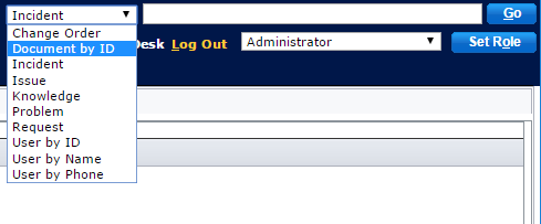

In the upper right hand corner of the CA Service Desk Manager UI main window, there is a drop down list to the left of the search bar containing the searchable record types. These searchable record types are referred to as "Go Resources". You can define the "Go Resources" available for each role.
How do you modify the search criteria that appears in the drop down menu?
CA Service Desk Manager - all versions
If you find that a certain role does not have access to search by certain criteria (for example a level 2 analyst is unable to search document by ID), you can modify the drop down menu for the role by following these steps:
