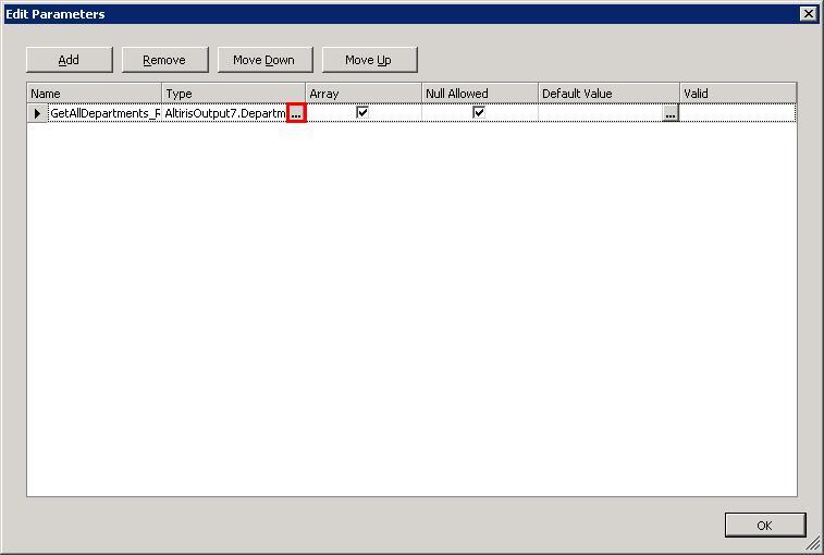

  13. In the Edit Parameters window, click the ellipsis in the Type column.
  14. In the Select Data Type window, type ‘getalldepartments’ in the Search box, select GetAllDepartmentsReportResult and click OK.
  15. Click OK again on the Edit Parameters window and again in the Get All Departments (Cached) Editor window.
