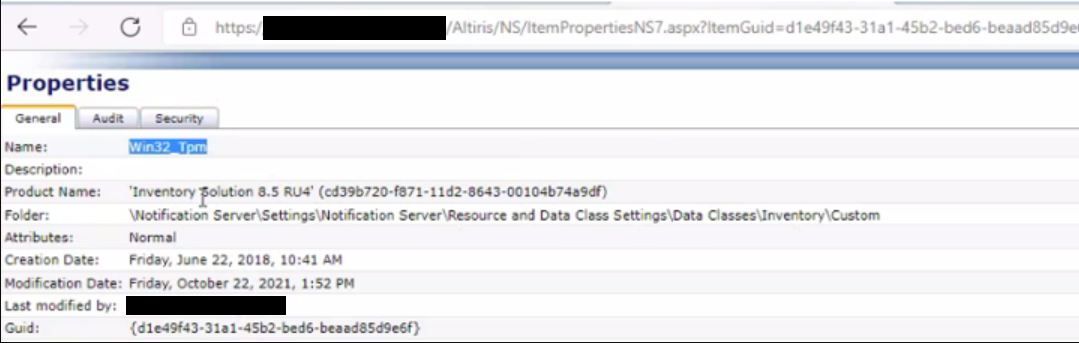

5. Find the dataclass name associated with the dataclass GUID. You can use the following link on your SMP Console and just replace the "ItemGuid" with the dataclass guid that you are trying to find:
https://smp.domain.com/Altiris/NS/ItemPropertiesNS7.aspx?ItemGuid=28cc7402-0a7f-40b8-acf9-73db2ad654de&view=properties&ConsoleGuid={3faa8b67-250b-42ad-8186-fe2f49a9e707}
It should return a page like this:
6. In this example, the affected dataclass is called "Win32_Tpm". This is a custom inventory dataclass. If you open "Resource Manager" for that client machine, if you go under View>Inventory, you should be able to find the dataclass and confirm what field name is the one with invalid characters. In this example, it is called "ManufacturerVersionInfo"
7. From here, you can either edit the custom dataclass and delete the affected field, disable the inventory policy that is calling out to collect the data for this dataclass, or just ignore the error messages now knowing what is causing it.
