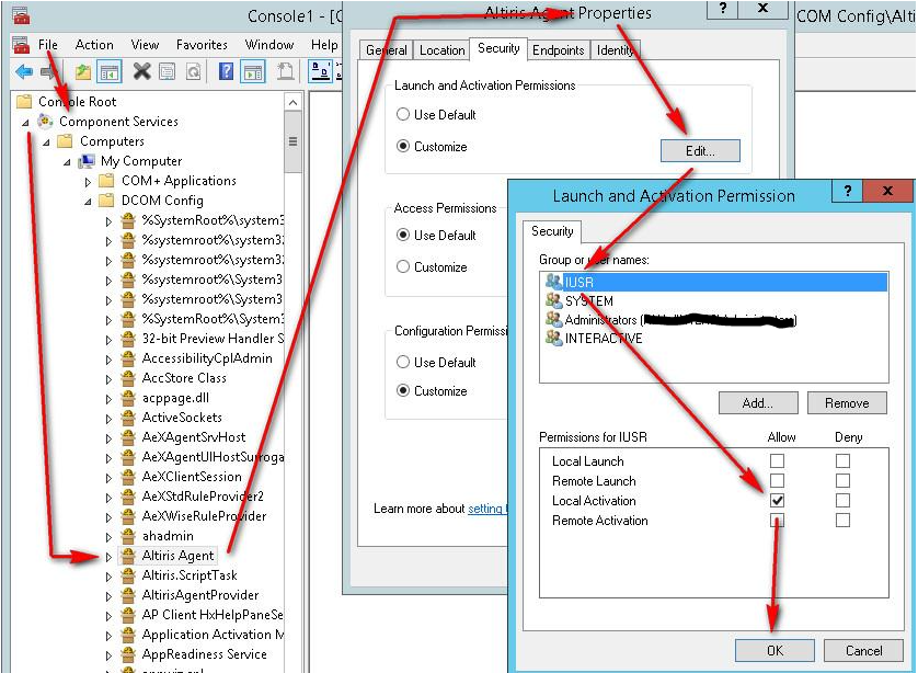

This is not a quite supported scenario (package server on an NS), and even a performance degrading approach since the package server on NS will duplicate all packages, consuming double disk space, it will also consume processing resources, decreasing the NS speed.
As for the described problem: The attempt to receive the snapshot is done to the package server-owned ASP page which tries to create a COM object of SMA, in order to get the package details and return the snapshot. This is done through VBScript in "GetPackageSnapshot.asp" script and this attempt failed.
The actual fail is on the "NS" side and the new package server is playing as a "client" in this game. The error is actually on the NS from its package server portion since the package service was installed. You can reproduce this issue easily by removing IUSR from DCOM, but since DCOM is set by PS automatically, it is possible there could be something else in play, like global policies or some other security tools. It is better to compare & check all permissions in DCOM for the "Altiris Agent" record.

  1. Check DCOM permissions in "MMC" console (Component Services>Computers>My Computer>DCOM Config>Altiris Agent)
  2. IUSR user is used by IIS to launch COM objects and it should have the DCOM permission set (on the PS which is on NS). By default, those permissions are set by Package Server but most probably on this PS-on-NS machine, they were somehow changed or failed to be set.
