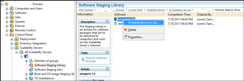

UnStage (This is the recommended way)
This removes the package from the Scalability Server and tells the Domain Manager that the file is removed. There are 2 places to do this:

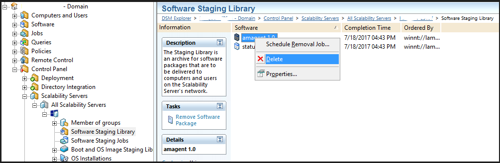

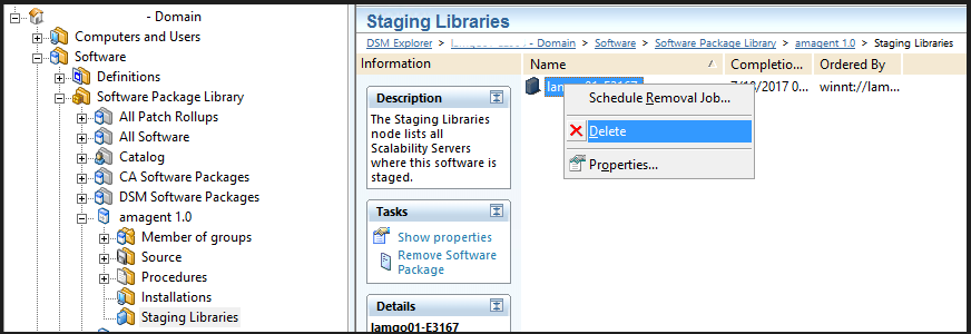

- Thru the Scalability Server section of the GUI:
- Thru the Software Package Section:
