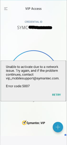

A. New installation is unable to activate (provision an OTP Credential)
Error Message: Unable to activate due to a network issue. Try again, and if the problem continues, contact vip_mobilesupport@symantec.com.
Error code: 5007
If the latest version is already installed, attempt the following:
  1. Reboot the device.
  2. If the error repeats, and the device is connected to WiFi, disable WiFi and attempt the activation again. If the device is already on a carrier data network, attempt the activation on WiFi.
  3. If neither of the above resolve the issue, uninstall VIP Access, reboot the device, and reinstall VIP Access.

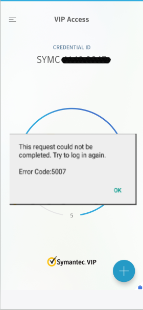

B. Push authentication will stop working.
Push authentication notifications from Google will reach the device. When a user launches the app, or if its already open, retrieving details of the location the user is attempting to login can't be retrieved so the prompt to Approve or Deny is never displayed.
Error Message: This request could not be completed. Try to log in again.
Error Code: 5007
