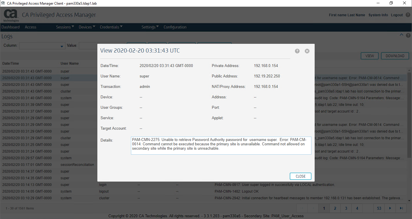

Pam330a5.ldap1.lab launches the app but as it fails to retrieve credentials it closes by itself.
Sessions log shows the Primary Site is not available and an error is reported.
