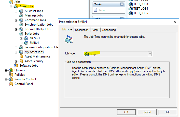

1- In DSM Explorer create an Asset Job of type script. Give it a name

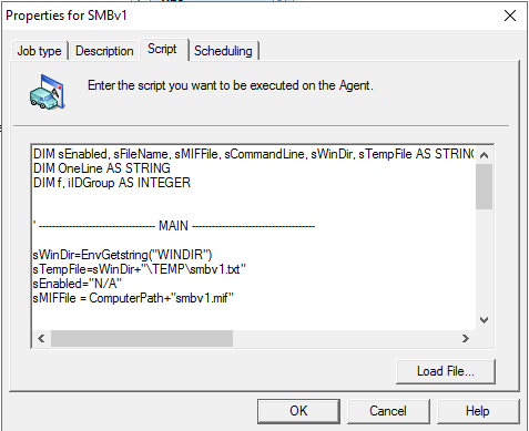

2- In script tab put the content of file smbv1.dms

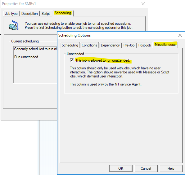

3- In Scheduling options, in tab Miscellaneous, check option "This job is allowed to run unattended"
