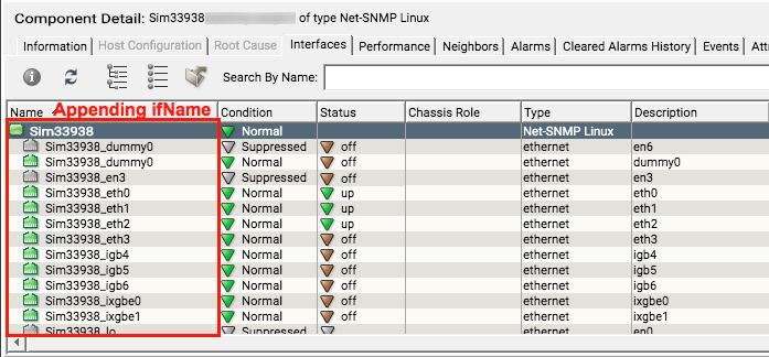

By default, Spectrum will name interfaces using the device's model_name and append the ifName of the interface.
example
In some instances, a user may prefer to have the ifIndex, ifDescr, or ifAlias appended to the name
  instead of ifName.
