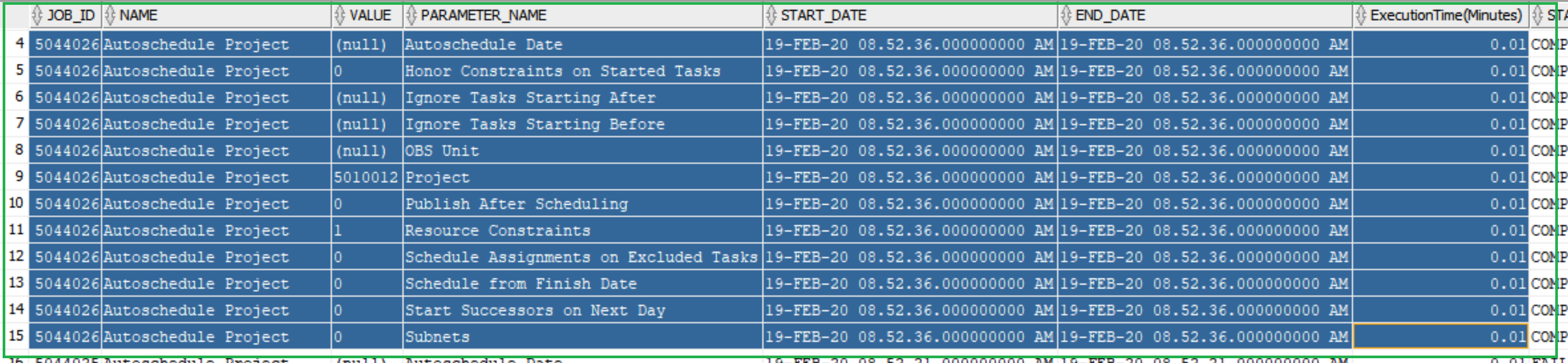

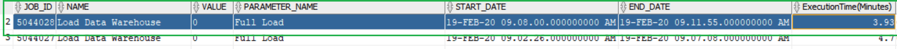

select@select:dim:user_def:implied:d0:rownum:row_num@,@select:dim_prop:user_def:implied:d0:job_id:job_id@,@select:dim_prop:user_def:implied:d0:name:job_name@,@select:dim_prop:user_def:implied:d0:value:parameter_value@,@select:dim_prop:user_def:implied:d0:parameter_name:parameter_name@,@select:dim_prop:user_def:implied:d0:start_date:start_date@,@select:dim_prop:user_def:implied:d0:end_date:end_date@,@select:dim_prop:user_def:implied:d0:execution_time_minutes:time_taken_min@,@select:dim_prop:user_def:implied:d0:status_code:job_status@,@select:dim_prop:user_def:implied:d0:username:job_scheduled_by@,@select:dim_prop:user_def:implied:d0:scheduler_id:job_executed_scheduler@from( SELECT row_number() over (order by jrun.start_date asc) as rownum, jrun.job_id, j.name, jparam.value, ccn.name parameter_name, jrun.start_date::timestamp as start_date, jrun.end_date::timestamp as end_date, round( jrun.total_execution_time / (1000 * 60), 2 ) execution_time_minutes, jrun.status_code, sr.full_name username, jrun.scheduler_id FROM cmn_sch_job_runs jrun JOIN cmn_sch_jobs j ON j.id = jrun.job_id JOIN srm_resources sr ON sr.user_id = jrun.user_id LEFT JOIN cmn_sch_job_run_params jparam ON jparam.job_run_id = jrun.id LEFT JOIN cmn_view_attributes att ON jparam.attribute_id = att.attribute_id AND att.display_order = 0 LEFT JOIN cmn_captions_nls ccn ON ccn.pk_id = att.id AND ccn.table_name = 'CMN_VIEW_ATTRIBUTES' AND ccn.language_code = 'en')qwhere @filter@
Some examples of interpreting the query result:
