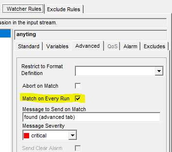

Logmon's Match on Every Run option enables the probe to match values for the specified format rule each time a log file is scanned.
For example, some applications write heartbeat messages to a log. If a match is found, the probe generates alarms as configured in Message to Send on Match. If the match is not found the probe generates the alarm that is configured in the Standard tab.

While using Match on Every Run option on a Watcher Rule of a "full" or "full_time" mode profile unexpected/inverted alarms are observed.
With the combination of Match on Every Run and full mode the probe will no longer send alarms as described in the documentation, but it may invert the alarm or send unexpected alarms.
