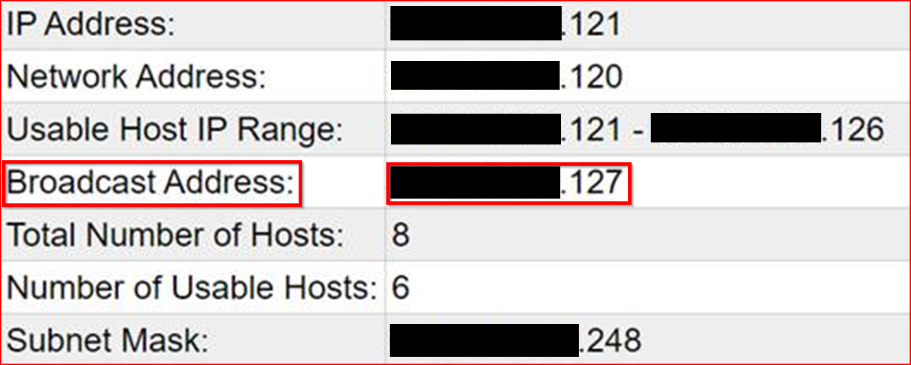

INFO  | 6dcf-thread-3457 | AAAA-MM-DDTHH:MM:SS,NNN | DeviceDiscoveryTask | scovery.impl.DeviceDiscoveryTask 1723 | .im.aggregator.discovery |       | x.x.x.127 (64691546)'s primary IP was the network ID or broadcast address. It will be deleted.
It seems the IP address of the device (x.x.x.127) matches the broadcast IP address of one of the networks discovered in the device. We consider that as non valid IP address
Device information:
To confirm run snmpwalk:
snmpwalk -v 2c -c <ro_community_name> <ip_address> 1.3.6.1.2.1.4.20.1.3
