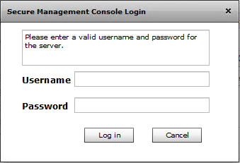

To log in to Config Xpress for Broadcom Identity Manager, you must use the credentials associated with the Identity Management Console (the "admin" or "imadmin" user) rather than a local operating system user
User and password must be entered when trying to connect to IM server in Config Xpress.

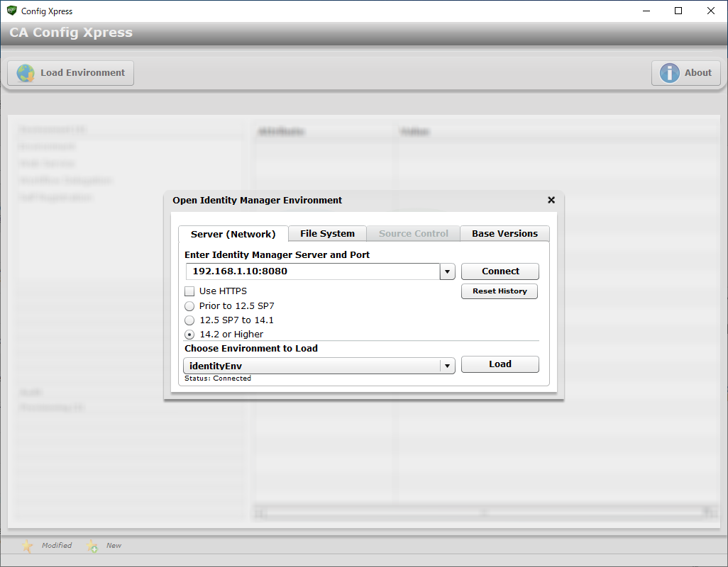

  • Virtual Appliance:
Identity Manager Server and Port: IP address:8080 (or hostname:8080)
Username: admin
Password: Password for Management Console admin

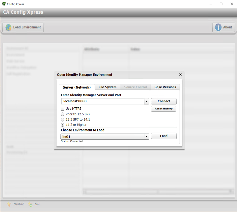

  • Standalone:
Identity Manager Server and Port: localhost:8080
Username: admin user of Management Console (imadmin by default)
Password: Password of above
NOTE: This is the password used to access the Identity Management Console (typically http://<server>:8080/iam/im/manage
