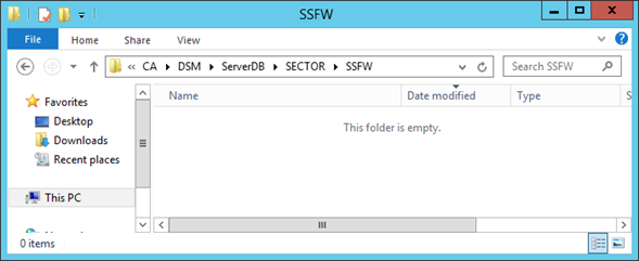

After Scalability Server’s Collect Task execution, no files are being generated under SSFW folder:

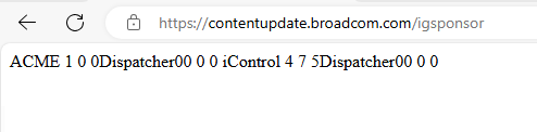

1.- Connectivity to the content site (https://contentupdate.broadcom.com/igsponsor):

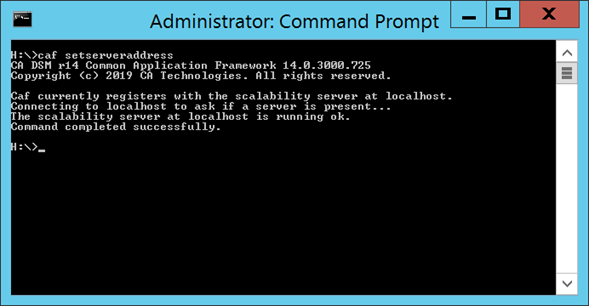

3.- ‘caf setserveraddress’ should point to local host on Domain Manager and Sacalability Servers:

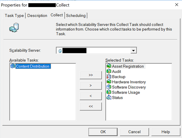

If all the above tests are OK, probably there is a configuration missing on the Collect Task itself.
In order to verify this, go to Engine where the Collect Task is placed, click on it to see its properties, navigate to Collect tab and verify the task “Content Distribution” is selected (it should be on the right panel under ‘Selected Task’), if it’s on the left panel, the Signature file won’t be generated:
