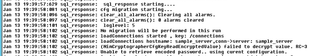

When we try to configure the sql_response probe I get the error "the sql_response is not running!!...You must start the probe in order to save..."
sql_response probe logfile shows following error messages:

The sql_response probe is installed on the primary hub where ppm probe is running
Do not put the sql_response probe on the hub running PPM.
Please set the environment variable NIM_PROBE_CRYPTO_MODE to TWOFISH or AES_128 in the controller probe.
