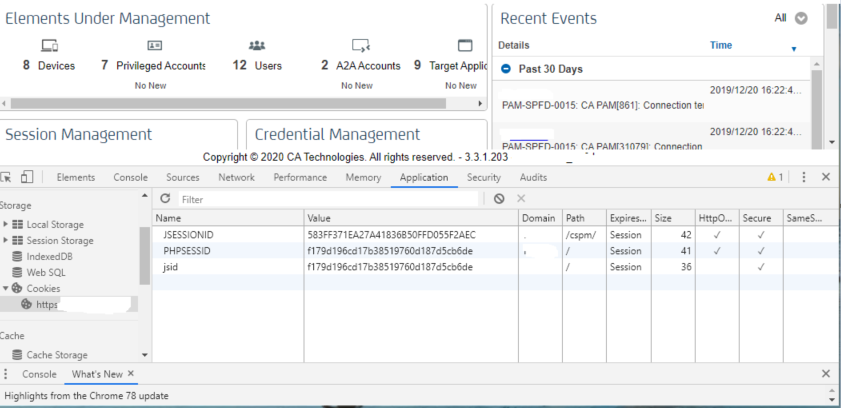

During vulnerability scans, this particular issue can cause false positives for certain URLs.  You can check the problem by using a browser to test.  You can use either IE or Chrome.  In both browsers there are tools that can show you whether the browsing is actually protecting you.
To check for a vulnerability in your Chrome browser:
1- log into the url for the CAPAM address that had the issue.
2- click on the three vertical dots to the right in the browser bar.
3- select "More Tools/Developer Tools and a developer screen opens at the bottom of your screen.
4- If it is not already on the Application tab, select the Application tab.
5- in the left hand side, go down to Storage/Cookies and click on the arrow at Cookies so that the arrow is pointing down, and proceed to log into CAPAM.
6- the url for your CAPAM should appear under cookies, click on that url.
7- the result will show results of JSESSIONID (JSON) and PHPSESSID (PHP) for checked for HttpOnly and checked for Secure as well, meaning it is protected.
See the attached screenshot of the Chrome screen with the results of the Tools/Cookies page:
