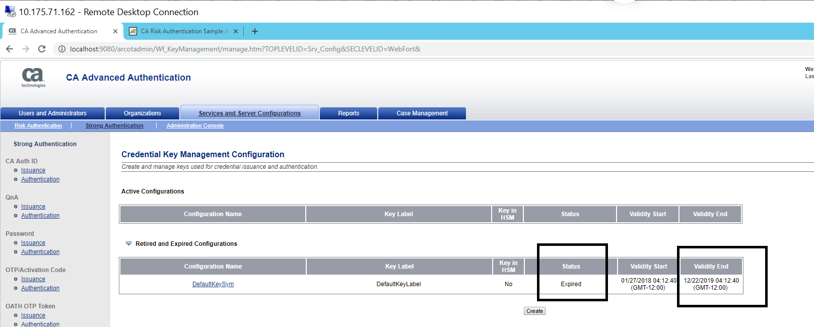

The issue (authentication failures) is  happening because the Domain Key related to ArcotID Credentials has  expired, we can validate that by looking into the below Admin UI configuration screen -
1. Login to Admin Console with Global Admin privilege
2. Go to Services and Server configurations tab
3. Strong Authentication tab
4. Credential Key management and look for the validity end date of the default Domain key.

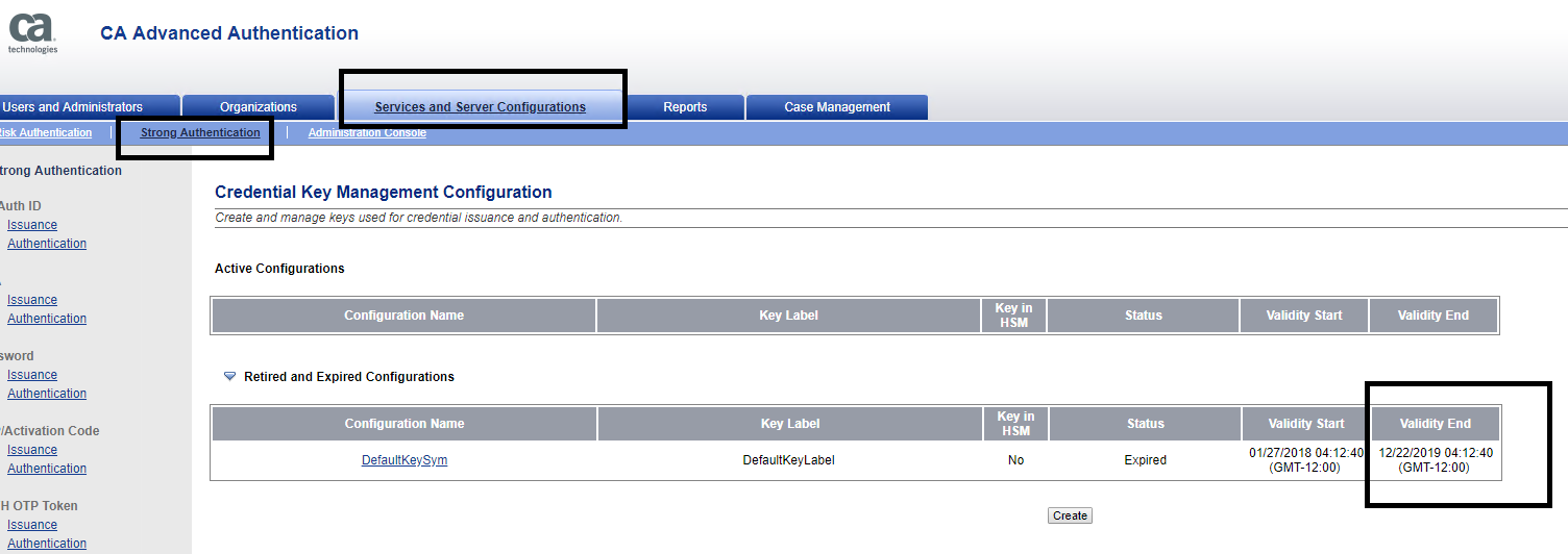

The issue is happening because the Domain Key in ArcotID Crednetial is expired, we can validate that by looking into the below configuration -
4. Credential Key management and look for the validity end date of the default Domain key (in the Admin UI  screen shot below 12/22/2019). Make note of this date. The screen shot below shows validity expired on 12/22/2019 and note this key is marked with status as "Expired".

  1. Login as a Global Admin and then navigate to the “Services and Server Configuration” followed by “Strong Authentication” tab to get to the screen as shown below. Note down the “Validity End” as in this example 12/26/2019 04:12:40 (GMT-12:00)

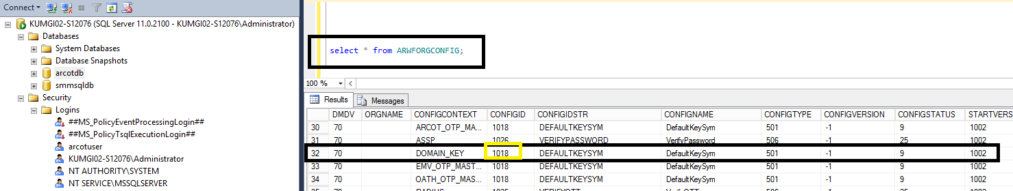

2. Go to Strong Auth database and look for table ARWFORGCONFIG. Note down the “CONFIGID” where CONFIGCONTEXT is “DOMAIN_KEY” and CONFIGIDSTR value as DEFAULTKEYSYM and CONFIGNAME as DefaultKeySym. In this example “CONFIGID” is 1018.

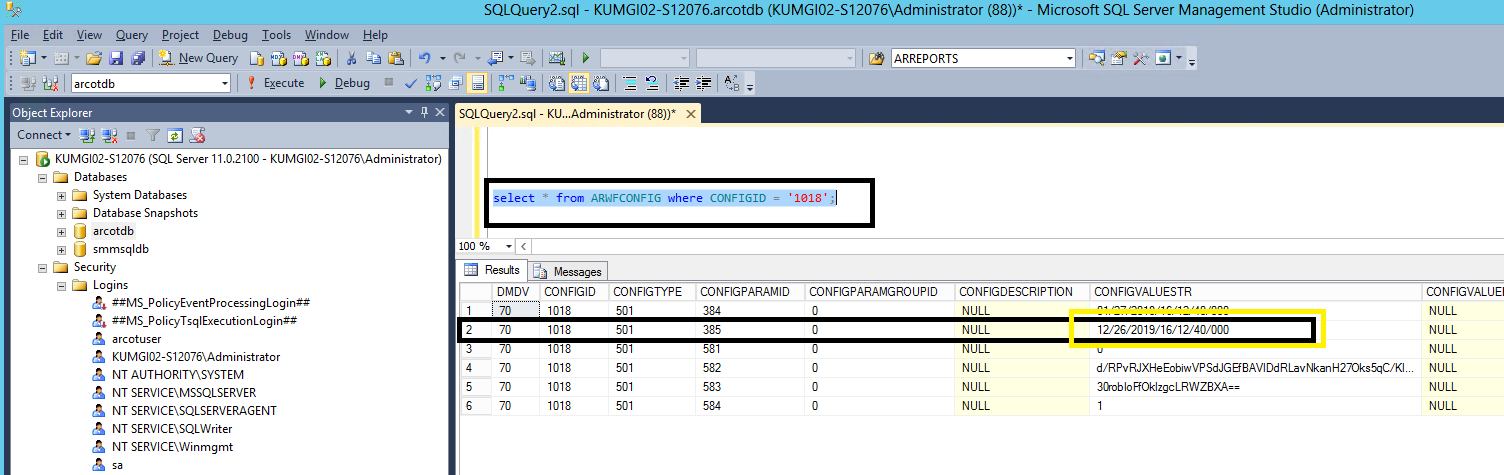

3. Look for the value of CONFIGID (in this example “1018”) in ARWFCONFIG table and the expired date as in this example “12/26/2019” (in column CONFIGVALUESTR). This is the row we will be updating to extend the validity of the expired Domain Key
4. Increase the validity end date by updating this row in ARWFCONFIG table as shown below where we are extending the validity end to year 2039. The update query for this specific example  is as follows:
UPDATE ARWFCONFIG SET CONFIGVALUESTR = '12/26/2039/16/12/40/000' WHERE CONFIGID='1018' and CONFIGPARAMID='385';
