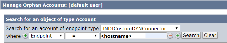

Endpoints > Manage Orphan Accounts search is not optimized. When we use 'where' clause to scope the search for particular Endpoint instance (where Endpoint = <Endpoint's name>), although the result is correct, Provisioning etatrans log shows Provisioning Server invokes search that retrieves all account data in Provisioning Directory including the ones belong to other Endpoint instances. So the 'where' clause is not honored.
We have created custom JNDI DYN Connector and have multiple Endpoint instances for the Connector/Endpoint Type. Considering huge volume of accounts on the Endpoints in the environment, this may cause performance issue.
