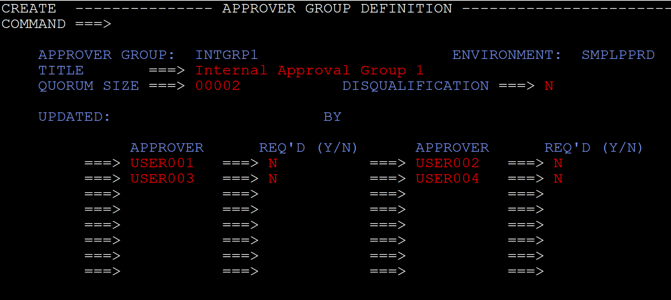

4. 4. After the Security Admin creates the external approver groups, then the Endevor Administrator can create/update the approver groups in Endevor. The Approver Group names that are defined in Endevor must be the same as the Approver Groups you have defined in the external Security package. If the Approver Group names defined to the security package are the same as the ones defined in Endevor, then, update the Approver Group definition in Endevor as follows:
Existing Internal Approver Group

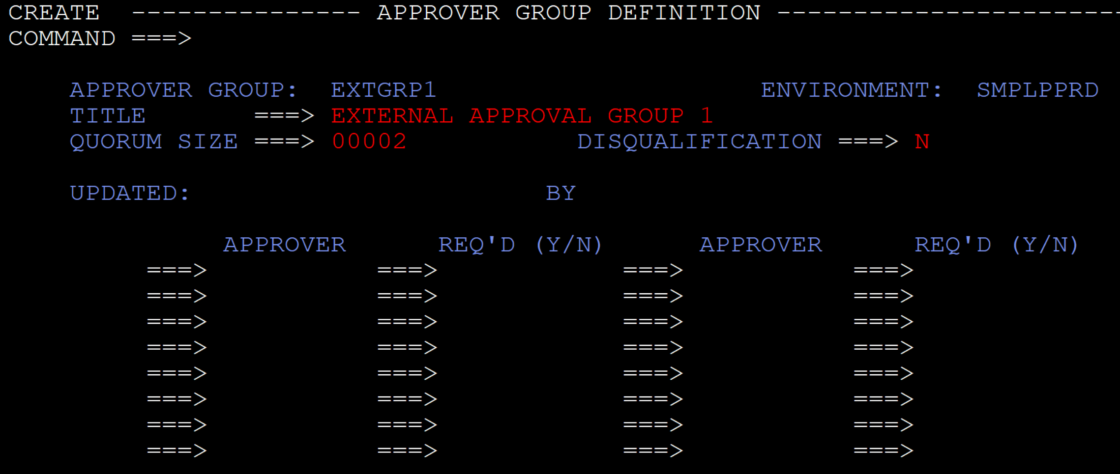

Update the existing Internal Approver group – remove all the USERIDs of the approvers. For an externally defined Approver group the Quorum size the acceptable values are 0 – 32760.
