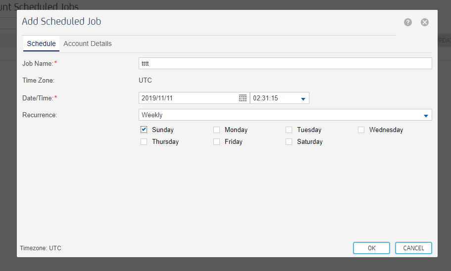

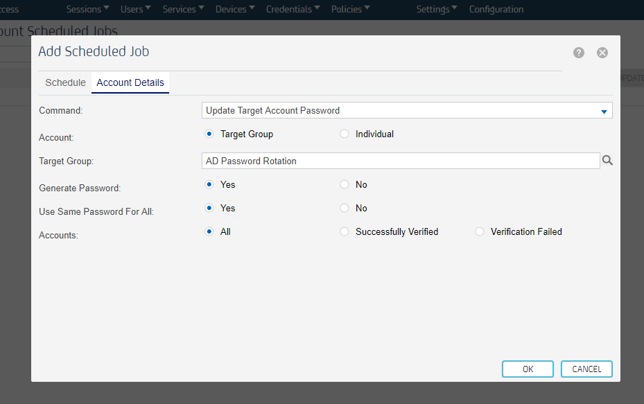

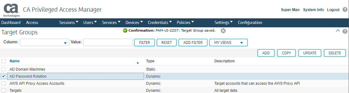

In the following sample, there is "AD Password Rotation" Target Group that covers the AD users.
Also, you can set a scheduled job to run daily for the "Verification Failed" condition.

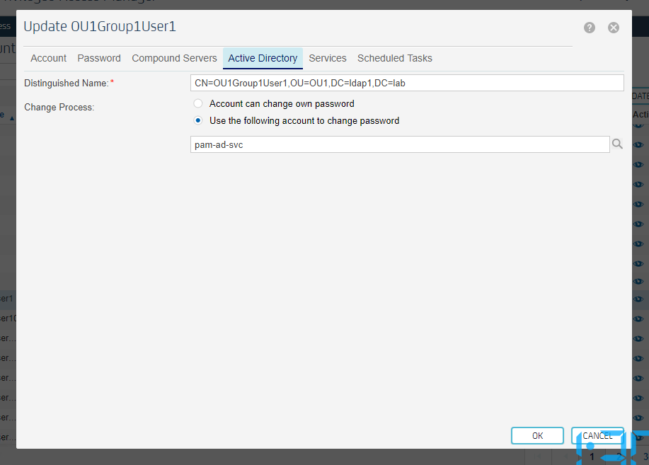

Obviously you should have a separate AD admin account that would update AD user password and not set to "User can change their own password".

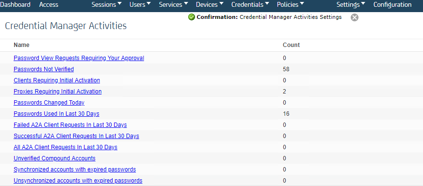

In case if you want to get a list of locked account, there is no specific report to cover just that but you can use the "Passwords Not Verified" report.
