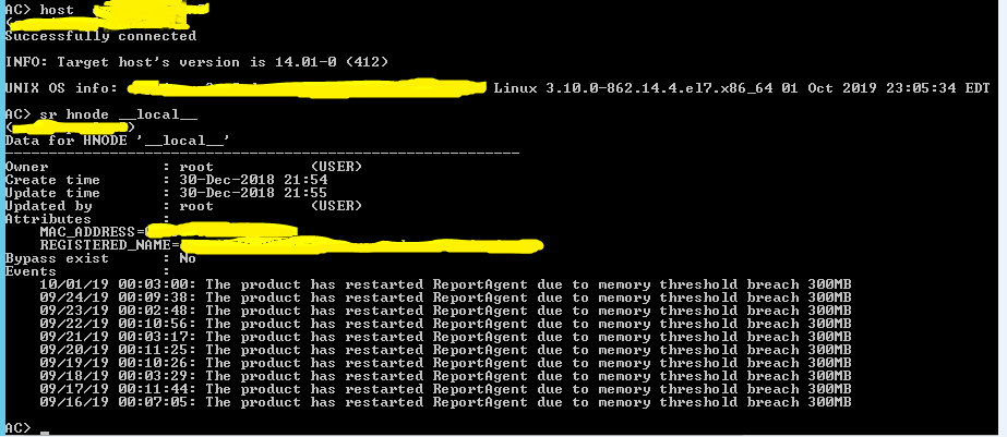

PIMv14  agents running on RHEL6.10 and RHEL 7.5 are showing event messages on our endpoints.
This can be seen when you query for a deployed policy on the endpoint using the selang command:-
sr hnode __local__
The observed message says:-
"The product has restarted ReportAgent due to memory threshold breach 300MB"
What does this message mean and if this is an issue what is the resolution.?
Finding from the seosdb:
editres HNODE ('__local__') attributes+(REGISTERED_NAME=server.example.com MAC_ADDRESS=##-##-##-##) events+('Type=Restart;Time=1570939786;Module=ReportAgent;Reason=Memory;Count=300' 'Type=Restart;Time=1571025726;Module=ReportAgent;Reason=Memory;Count=300' 'Type=Restart;Time=1571198506;Module=ReportAgent;Reason=Memory;Count=300' 'Type=Restart;Time=1571112571;Module=ReportAgent;Reason=Memory;Count=300' 'Type=Restart;Time=1570852946;Module=ReportAgent;Reason=Memory;Count=300' 'Type=Restart;Time=1570767010;Module=ReportAgent;Reason=Memory;Count=300' 'Type=Restart;Time=1570680165;Module=ReportAgent;Reason=Memory;Count=300' 'Type=Restart;Time=1570594230;Module=ReportAgent;Reason=Memory;Count=300' 'Type=Restart;Time=1570507390;Module=ReportAgent;Reason=Memory;Count=300' 'Type=Restart;Time=1570421450;Module=ReportAgent;Reason=Memory;Count=300')
