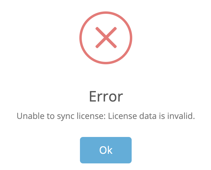

After clicking the "Sync License" button, the following error is displayed:
Error
Unable to sync license: License data is invalid.
