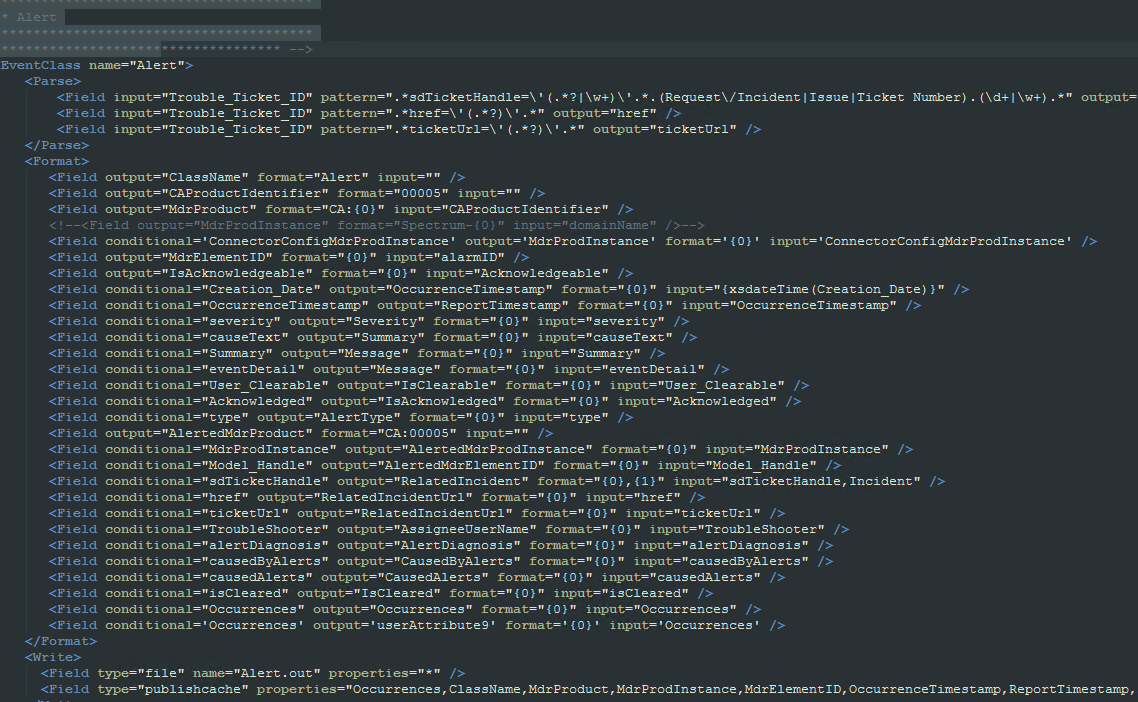

- On your Spectrum connector save a copy and edit CA\SOI\resources\Core\Catalogpolicy\spectrum_policy.xml. Add following lines before </Format> tag. See also screen shot below
  <Field conditional="Occurrences" output="Occurrences" format="{0}" input="Occurrences" />
  <Field conditional='Occurrences' output='userAttribute9' format='{0}' input='Occurrences' />
- Append "Occurrences" to publishcache Field type inside <Write> section. See screen shot below
  Note: The userAttribute9 above is used as an example. There are 10 user attribute (1-10) and you'll have find and use one that is not used for any other purpose. So you need to decide first which empty (not used) user attribute you want to use              because later on in the procedure we'll be renaming this to "Occurrences" and add a new column to the Alert console.

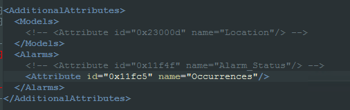

- On your Spectrum connector save a copy and edit CA\SOI\resources\Configurations\SpectrumIM\AdditionalAttributes.xml file and add the following line in <Alarms> section
   <Attribute id="0x11fc5" name="Occurrences"/>
- Recycle the CA SOI Integration Services on the Spectrum connector machine for the above changes to take affect.

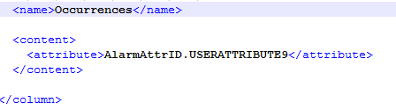

- Go to your SOI UI server, save a copy then edit  \CA\SOI\SamUI\webapps\sam\WEB-INF\alarm\config\column-userDefined9-config.xml. We are editing this file because as mentioned in the above note section we are using userAttribute9 as                  example to rename it to "Occurrence" and to add the column to the SOI console.
- Change only one line in the file between the Name tag (see screen shot)
  from   <name>com.aprisma.spectrum.app.alarm.client.detail.USERATTRIBUTE9</name>
  to: <name>Occurrences</name>
- Save the file and recycle the CA SOI User Interface Server service. Close and reopen the SOI console.
