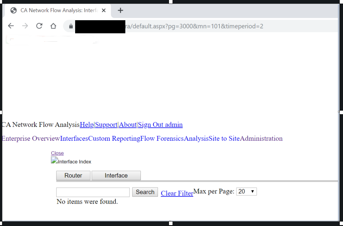

New installation of NFA  After installation not able to load the NFA console as expected. The gui menus not populating correctly in browser after login

Some prerequisites related to IIS / ASP were missing as documented in the install docs.

 Since getting error to enable IIS-ASPNET using NFA-fix.bat can use information below
How to register ASP.NET on Microsoft Windows Server 2016
To register ASP.NET on Microsoft Windows Server 2016, launch an elevated command prompt and run the following command:
dism /online /enable-feature /featurename:IIS-ASPNET45
After this process was done the NFA console was launching with all menus populated correctly
