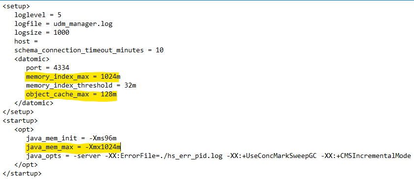

Below is an example of what will cause this problem.
The datomic memory settings in question memory_index_max and object_cache_max exceed 75% of the java_mem_max:
***Adjust the memory setting so that memory_index_max and object_cache_max do NOT exceed 75% of the java_mem_max***
