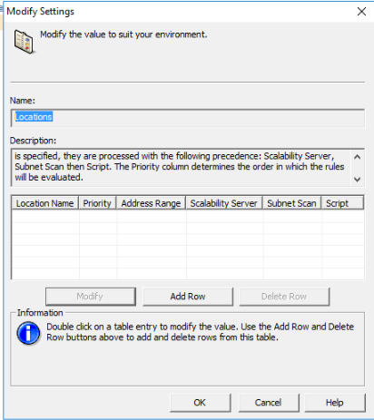

In configuration policy under DSM/Agent/Common Agent/Common/Location Awareness/Locations it is possible to add rules in a table.
On column of the table is script.
How to use it ?

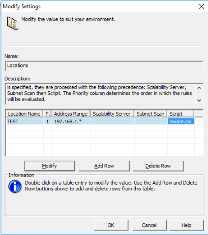

2- Copy the file aware.ips to the Agents under C:\Program Files (x86)\CA\DSM
3- In configuration policy location Awareness table, add aware.ips in script column.
This script will be executed by "caf register" with following command line :
dmscript.exe aware.ips -o "C:\WINDOWS\TEMP\itcm_server_id_script_output.txt" -x "C:\WINDOWS\TEMP\itcm_server_id_script_errors.txt" -a "192.168.1.153" -e "C:\WINDOWS\TEMP\itcm_server_id_engine_errors.txt"
-a : is the ipaddress to agent matching the rule
-o : is the output file which should contain the Scalability Server Name to use
If Agent ipaddress matches the rule TEST, "caf register" executes the script aware.ips and read the file C:\WINDOWS\TEMP\itcm_server_id_script_output.txt to find which scalability server to use.
If communication with this scalability server is working, it is used by Agent.
