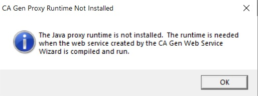

After moving Gen 8.6 to new Windows Server 2016 running the Toolset Web Service Wizard Plug-in gives initial message that the Java Proxy generator and/or runtime is not installed i.e.
CA Gen Not Installed
The Java proxy generator is not installed. The CA Web Service Wizard needs to use the XML code generated by the Java Proxy generator in order to create the WSDL file.
CA Gen Proxy Runtime Not Installed
The Java proxy runtime is not installed. The runtime is needed when the web service created by the CA Web Service Wizard is compiled and run.
The messages are non blocking i.e. if hit OK the Web Service Wizard dialog will continue and generation, build, deployment and execution can still be successful.

The second message "The Java proxy runtime is not installed. ..."  is due to the Java Proxy feature not being installed by using the "Custom" CA Gen installation.
To add the Java Proxy feature after the initial GA install, the following steps can be used.
  1. Go to Control Panel\Programs and Features.
  2. Use right mouse button on "CA Gen 8.6" and select "Change".
  3. When the installer starts select Modify and select the "Java Proxy" feature.
The message "The Java proxy runtime is not installed" should then no longer occur.
