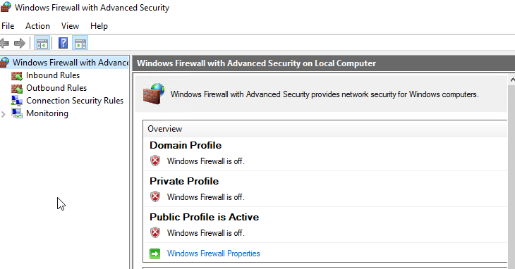

Only as a test you may disable windows firewall to make sure it was a problem:
