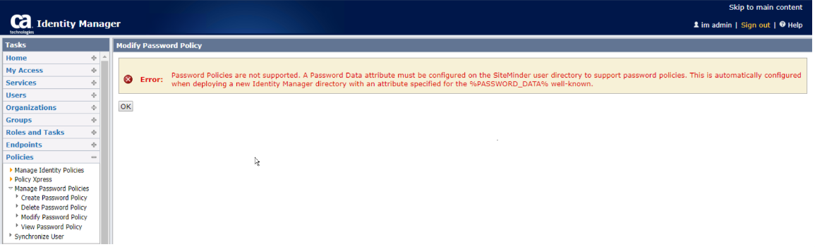

For example, if we created the imssouser that has scope to the Identity Manager domain.
And then we modified the ra.xml accordingly and restarted Identity Manager. Identity Manager was started up
successfully and we can login to Identity Manager User Console. However, when we go to Policies > Manage Password Policies > Modify Password Policy we got the following error.
Error: Password Policies are not supported. A Password Data attribute must be configured on the SiteMinder user directory to support password policies. This is automatically configured when deploying a new Identiy Manager directory with an attribute specified for the %PASSWORD_DATA% well-known.
