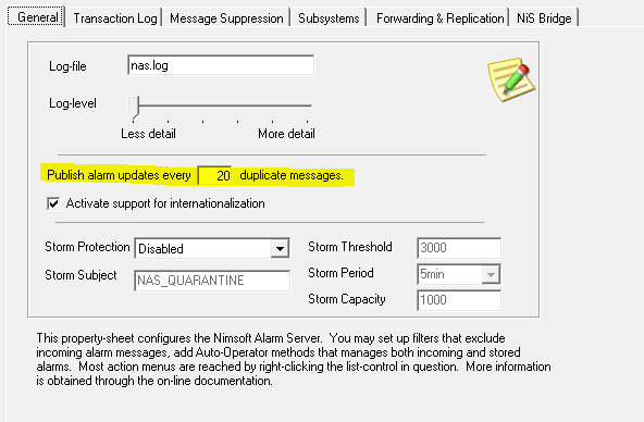

NAS GENERAL Tab:
Publish alarm updates every " " duplicate messages
KEY: [supp_divisor = 20]
This value determines how often the 'suppcount' is updated in the NAS_ALARMS table in the database.db.
The first alarm has a value of '0'. This reflects in the IM alarm subconsole "count" value for each alarm. The first alarm will show in IM alarm details as Count = "1"
If supp_divisor =1 , at EVERY identical alarm, the count increases.
If supp_divisor =20 the 'suppcount' in the database.db and the "count" in IM will increase only once you receive the 21st suppressed alarm

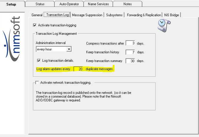

NAS TRANSACTION-LOG tab:
Log alarm updates every " " duplicate messages
KEY: transactionlog_divisor = 20
This value determines how often the 'suppcount' is updated in the NAS_TRANSACTION_LOG table in the transactionlog.db.
If transactionlog_divisor=1 , at EVERY alarm, the count increases.
If transactionlog_divisor =20 the 'suppcount' in the database.db will increase only once you receive the 21st suppressed alarm
