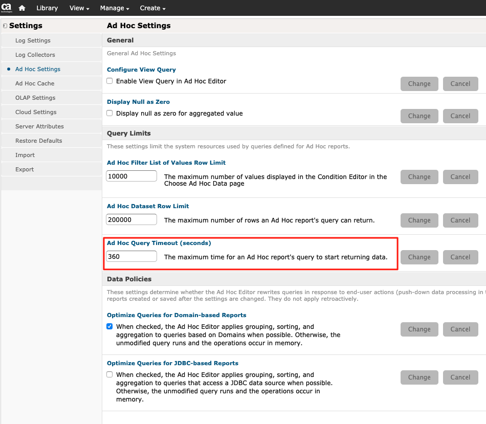

  • Jasperserver.log (Apache-tomcat/webapps/jasperserver-pro/WEB-INF/logs) shows there is a timeout (with the default timeout value being 360 seconds):
Caused by: com.jaspersoft.commons.util.QueryExecutionTimeoutException: jsexception.QueryExecutionTimeoutException
Arguments: 360,
1. Shorten the range for the data being queried.
or
2. Increase the timeout within Jaspersoft for Adhoc reports:
