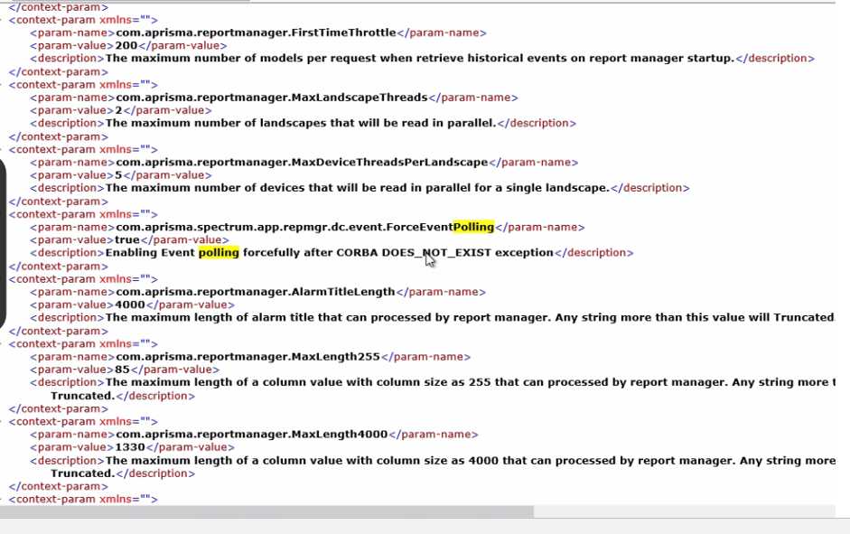

You can force the polling of the events to be done even after this exception, by executing the following procedure:
  1.  On the Spectrum OneClick server with SRM, open the following file:
    $SPECROOT\tomcat\webapps\spectrum\WEB-INF\web.xml
  2. Locate the following lines:
    <context-param xmlns="">
        <param-name>com.aprisma.spectrum.app.repmgr.dc.event.ForceEventPolling</param-name>
        <param-value>false</param-value>
        <description>
            Enabling Event polling forcefully after CORBA DOES_NOT_EXIST exception
        </description>
    </context-param>
  3. Set the above flag (<param-value>) from "false" to "true";
  4. Restart the tomcat;
