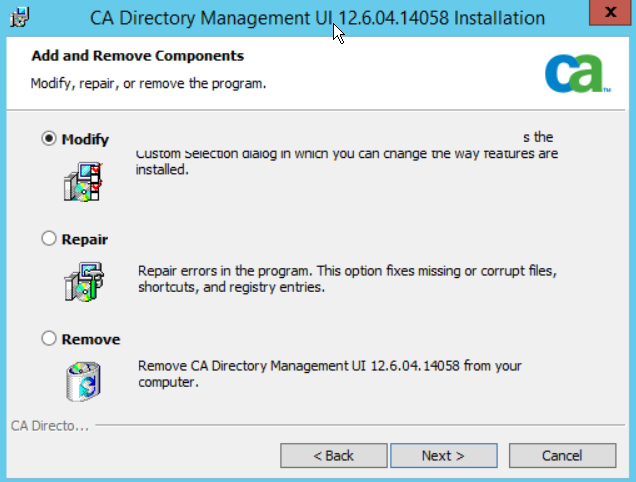

2. Mount the 12.6 CA Directory Management UI media and run dxmgmtuisetup.exe
3. At "Add and Remove Components" dialog select Modify

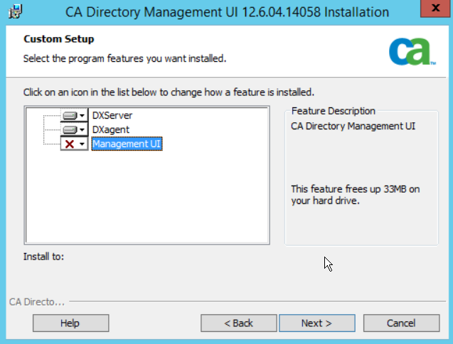

4. At "Custom Setup" dialog deselect only Management UI component
You can do similar procedure on Linux too.
