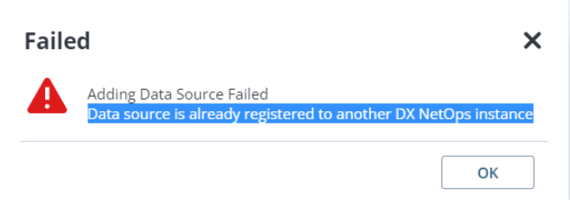

Adding Data Source Failed: "Data source is already registered to another DX Netops instance"

When trying to add a Data Aggregator Data Source to Performance Management getting an error:
"Adding Data Source failed.  Data source is already registered to another Performance Center"
Or
"Adding data source failed
