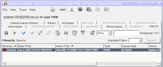

Spectrum "FAILURE TO BIND TO A TRAP PORT" alarm on VNM model - Cause Code: 0x10e05
Release : Any Spectrum version
Component : Spectrum Core / SpectroSERVER
There is another process that is bound to the default trap port 162 preventing Spectrum from binding to the trap port for trap processing.
